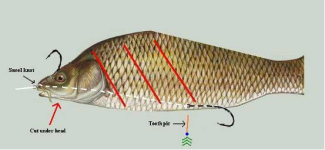

Ja thanks,I don't really want to rig the above carp as that is big to me.I will rather try whole 2kg carp.One question about the whole carp presentation.Will it be okay if I use the same size circle and hair rig method?I will cut away the gill plates,bash the head,cut three slices in each side and maybe spray that blood spray in the gills if it arrives.I also have a question it happened once or twice that something took a plattie and when it was close to the side it just goes slack?What can that be.Hook pull I doubt it as I use circles on every bait.

In rigging the bait, skuimkop has posted in one of the post with a diagram, on a bait that big i would rather use a 2 hook trace than the rig you used for the half. But again you could teach me something and prove that it works, my rigs would be alot easier if it did. On my baits i cut away gill plate, spray dead red inside the gills, leave it for 5 min than give it a quick spray as i take it out. I would slash it as you mentioned, but also have a small cut into the stomach cavity. Let the strong scent from the guts get into the water. Use as much natural scent as possible and use the dead red as an attracter, when you first use it, dont go overboard, a couple sprays is enough to last awhile.

personally i love the way skuimkop does the rig, and it is the one i use on any of my large baits and fillets. The surface area of the larger bait is obviously bigger and having that second hook gives me alot more confidence in a hook up. I have not noticed any preferance in what hook gets the most hook ups on e rig. So far i have had it pretty much even on top and bottom. My only difference to skuim is that i only use circle hooks, my hook ups are more solid and gives me the confidence to put more prssure on the fish during the fight. But try both GC, find what works for you.
nobbles
What i do is have the line in the cut under the head, so its flush with the top side of the head, than just have it on the under belly to the hook. I usually cotton my bigger baits to ensure the line is as flush against the bod as possible. I have also cut a grove in tilapia and had the line in the groove, but agin cotton to close the body around the line. Skuim may have his preffered method to get the line where he has it in the picture.

As jy die Karp op sy rug draai en jy steek 'n mes of pen tesun sy twee pektorale (pectoral) vinne in steek jy die mes of pen reg deur sy hart. Twee hart kloppe later en Karp is in Karp hemel. Werk wertlik goed en die vis is vinnig dood. Sien ook pic (rooi pyl) ook aangeheg.
