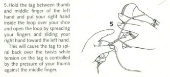

When I'm into a smash i use the following knot to save some time. it is a very good knot and i have not experienced problems with it.
dup-zn
The follwing knot is used to tie on my hooks and swivels.
I also use it to tie my leader to the bemini or the spider knot, I leave out step 3 and only use two loops to make my knot smaller. The same knot that Hennie Papenfus is using. It works like a bomb.
