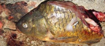

2. Dead mud fish/carp are the next best bait. If the carp is a bit big 3.5-5kg, I cut them from the front of the dorsal fin(just in front of the spike) at an angle down to the poepol(for lack of a better word). This will just open up the stomach cavity letting out the flavors. Always soften the head on these big baits by bashing them (use your brick sinkers)
Something like this?

Hi, the cuts are perfect and the illustrations well done. Only thing I would not agree with on a bait this size is choice and placement of the hooks. The hooks are too small and I would go with a single circle hook instead of tandem J. More so if I was fishing in a river due to increased chance of fouling.
From your last photo, the back hook is almost not visible and gape on the front hook is almost closed by the bait. For me a single big(at least 14/0) circle hook rigged on a bridle on the front side of the head would be much more successful.
When circle hooks rigged using a dacron bridle(even big ones on big baits), are swallowed with the bait, they will fold against the bait without bothering the barbel when it swallows the bait. When it takes off it will then hook-up in the corner of the mouth every time.
IMHO the way this one is rigged, the barbel will swallow the bait and when it takes off it MAY be hooked and the chances off getting hooked in the gut is also high, which will affect the well being of the barbel when released.  If the barbel spits this bait or if the angler strikes to soon chances are this bait will come out without hooking up properly and you could loose that once in a lifetime 100 pounder.
Part from the hook issue for me this is a nice size bait and well presented will produce a decent size fish.
