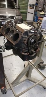

Hi All
Sorry for being so quiet, but there has been a bit of progress since i have been out of work for 5 months now due to Covid (Lots of time to do the things I have on hand)- which now has slowed down the project until we get called back to work.
So what has been done during lockdown...
  • Stringers have been replaced and new floors
    Heads have come back from the workshop - unleaded conversion complete
    Carb has been overhauled with new kit
    New water pump
    Overhauled Raw water pump
    Engine has been assembled and painted
    gearbox has been painted
    Complete new wiring throughout the boat.
    Gauges have been cleaned up - Still dont know what to do with the dash
    Started cleaning up all the Teak pieces.
    • During lockdown I have been busy in the garage with assembling the motor, making up new wiring looms, overhauling the raw water pump with new bearings and mechanical seals. Carb has been stripped, cleaned and assembled with original holley parts.
      Made up now wiring looms all new wiring keeping to the original wiring diagram with colors etc, just adding a few wires for future expansion. Ie. courtesy lights and electric back up fuel pump.
      I have received the boat back from the shop and have been filling a few holes on the boat that are no longer required and at the stage where is ready to be repainted.
      ill attach some photies to see the progress
