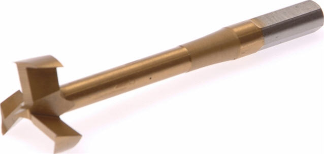

how did you make the eye sockets , since im having a little trouble with it.

Plenty of time, a small craft knife, sandpaper and a very nice and big cut to the finger. When the craft knife slips it does an awsome job of cutting fingers.

I'm sure there is an easier way to do it, maybe Bennie can give some advise, he is after all the master when it comes to making great lures. Help Bennie, don't want to cut myself again.

Get yourself a MAD drill bit. Multi Angle Drill bit. They work brilliantly.

Strange looking tool. Will Builders sell them?. Not in the mood to cut half my finger off again.

Not sure. I get them from the Mica here. Quite expensive but it is the answer for the eye socket recess. It's a Mastercraft product, so any of the stockists I'd imagine.

The Multi-angle bits are available from Builders, got mine there, and they really work well.
