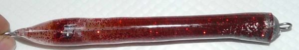

Played around with some moulds, everything from metal to candle wax...
Anyway, best thing I have used yet is a simple clear plastic tube. You can flatten and bend it to shape the lure, it's clear so you can see were the bubbles are, easy to insert the spring steel, you can clamp the end shut to get a flat head or leave it open to get a round head. Made a lot of errors with the first one but the basic conscept is pretty easy.

DJP
top view, bit crooked at the back...next time lol
