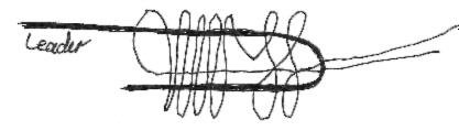

Howzit Keith. I only use the Albright knot and never have breakoffs. I catch mainly fish in the 5-10kg bracket from a boat. The trick is the end of the knot. I only use about seven winds around the leader. Remember, it is critical which way you insert the tag end through the loop after the winds. The one way works and the other doesn't. Practise a couple of times WITH MONO and you'll work out which is the correct way.
Now comes the trick. When using braid to mono, once you've completed the traditional Albright, don't tighten the knot yet. turn the tag end around the mono loop and put it back through from the opposite side and then once again from the original side. This creates a braided effect. Now, pull on the main line gently and it'll take the slack out of the back end of the knot. Then pull the tag and main lines together to finish.
If I was half as competetent as Reefer or Trophy I'd try a pic, but my attempt would probably resemble a burst bum so I'd rather not.
Dingleberry
Nah, not the same. I try to use less complicated stuff 'cause all my fishing is done from a 4.8m boat on the sea, so it bobs around a bit. It's just the standard Albright with a bit of a weave at the end. Here's a rough sketch. Sorry, I didn't have the time to do the job properly 'cause I'm off to Sedgefield for a bit.
